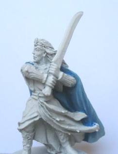

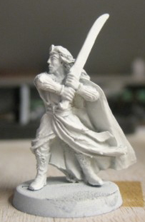

Step 1 Inner Cape
Once you’ve given the model a basecoat -which means you painted it totally black/white-, you are ready to proceed.
Make a 1:1 mix of Enchanted Blue (or Ultramarines Blue) and Ice Blue, and add that as a fist layer, then mix some extra Ice Blue through your previous mix and add a next layer, making sure to not cover up all of the first mix in the deeper parts of the cape. After you’ve added some Ice Blue several times, you add a little skull white to the mix, and apply that to the cape. Make sure that with every next layer of paint you keep seeing the previous one, in that way you’ll get highlights.
This is what your model looks like after step 1:

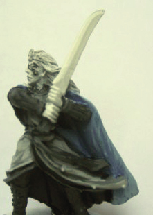

Step 2 Dark Clothing
If you primed (prime is basecoat) your model black then you can skip this first bit of step two. If you primed your model with white, then you should paint his boots, and all the clothing black, except for the inside of the cape, which you’ve already done earlier.
Whether you’ve primed black or white, you should now have the same set-up for the clothing. Now you should make a 1:1 mix of Codex Grey and Chaos Black. Once this mix is made, highlight all the clothing you’ve painted black with it.
This is what your model looks like after step 2:

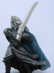

Step 3 Upper Robe
The robe is just a lot lighter then the rest of his clothing. Mix a little Codex Grey through Fortress Grey as a first layer. Then you highlight by adding some Fortress Grey to the previous mix and applying that to the model. Then you highlight your model with a bit of pure Fortress Grey. As a last layer you mix a little Skull White through the Fortress Grey and you apply that mix on the outer edges of the upper robe.
This is what your model looks like after step 3:

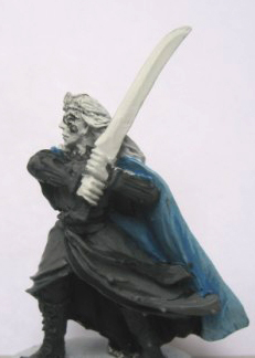

Step 5 Armour
Drybrush the chain mail with Chainmail.
“-For some obvious reason I think you’d have figured that out yourself”
Further more we’ve got the arm plating. Start by giving these a layer of mixed up Codex Grey and Fortress Grey. As a highlight add some extra Fortress Grey to your previous mix. As a last layer you should add a little Skull White to the mix and apply this mix to the outer edges of the plates.
This is what your model looks like after step 5:

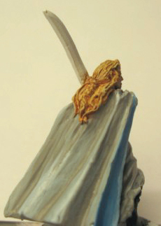

Step 8 Outer Cape
Give the outside of the cape a layer of pure Fortress Grey. Then add a little Space Wolves Grey through the Fortress Grey and apply a layer of this. Keep adding small amounts of Space Wolves Grey for each next layer. Keep in mind that with highlighting you want to be able to see every earlier layer. Like you are building a stair of colours. As a last highlight, add a little white to the Space Wolves Grey and apply that to the highest points of the cape.
This is what your model looks like after step 8:

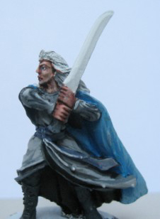

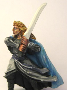

Step 9 Last Details
You start by painting the crown on his head and the emblems on his boots with Shining Gold. Then you give the gold parts a thin wash of Flesh Wash (or Chestnut Ink). Highlight the gold parts with a 1:1 mix of Burnished Gold and Mithril Silver. Give the sword a layer of Boltgun Metal. Then apply some Chainmail to the sword, making sure to leave the triangle piece of sword, right above his hand painted with only Boltgun Metal. As a last layer to the sword, highlight it with Mithril Silver.
The last thing you’ve got to do is painting the swords handle. Paint the handle by giving it a first layer of Scorched Brown, then highlight it with a layer of 1:2 mixed Bleached Bone and Scorched Brown.
This is what your model looks like after step 9:
“- I hope you enjoyed this tutorial, and that it may be of great help to you.”
